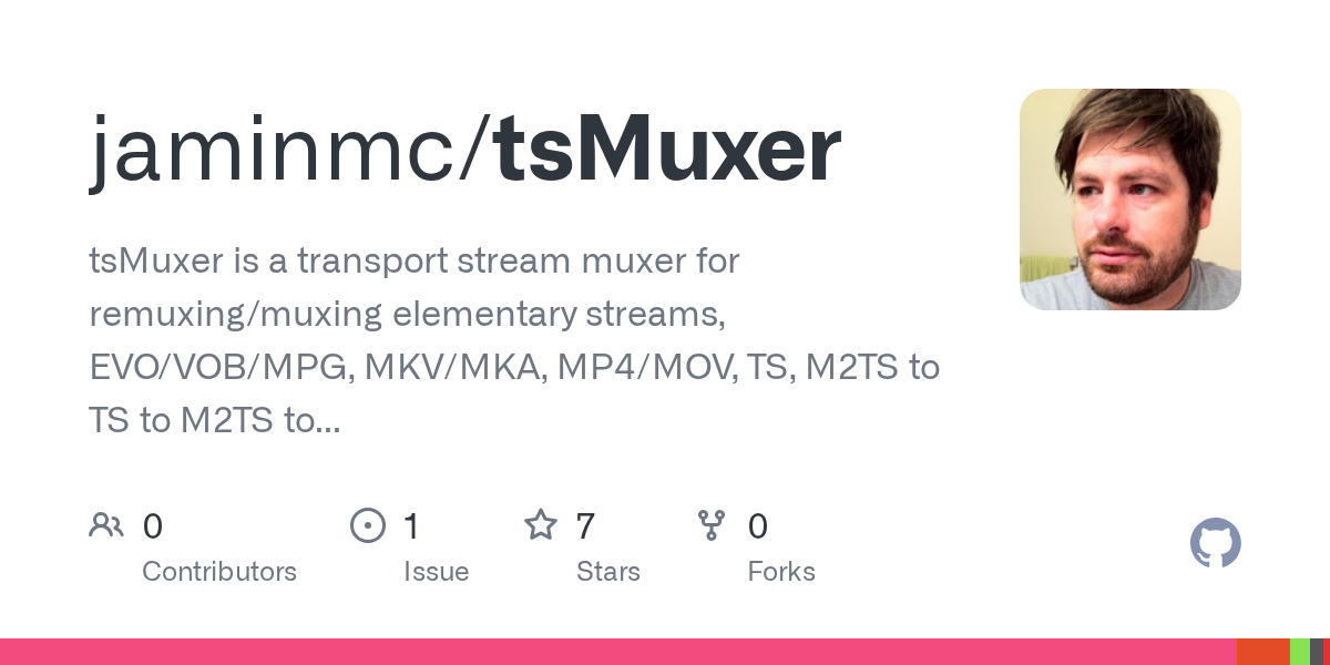

Некоторое время назад появился форк tsMuxeR:
This is a modernized fork of justdan96/tsMuxer, updated to C++20 with Qt6 support.

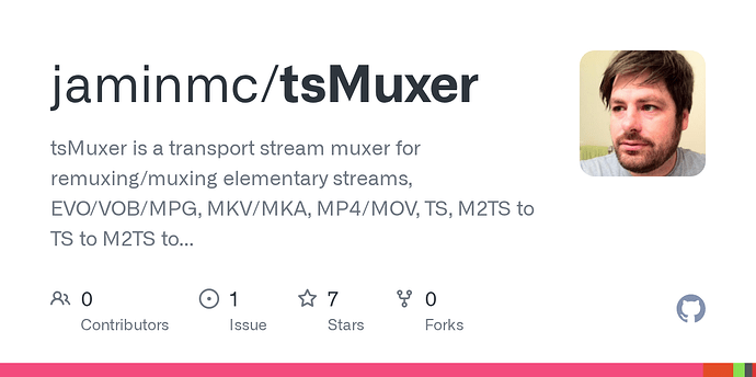

Ещё вариант tsMuxeR (форк на форк):
This is a fork of jaminmc/tsMuxer (itself a modernized C++20/Qt6 fork of justdan96/tsMuxer). It adds multi-layer disc authoring: a menu-preserving BDMV to ISO mode, a layer-break guard band for BD-R/RE DL and BD-R XL media, a fit-to-disc capacity guard, and a layer-break calculator in the GUI. See DISC_AUTHORING.md
